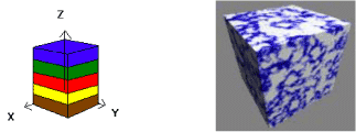

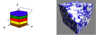

3D Texture Technology The development community is constantly looking for ways to improve the speed and flexibility of their games and applications. While visual effects such as lightning, volumetric fog, and explosions are all possible with a series of 2D textures, the implementations are not flexible and can create overhead due to texture swaps, API overhead, and a reduction in texture pipeline efficiency. The NVIDIA® nfiniteFX Engine delivers the first true 3D texture technology aimed at consumers. NVIDIAs 3D texture technology allows for more flexibility, performance, and ease of implementation than traditional texturing techniques. The nfiniteFX engine can use a 3D texture from any angle or orientation (not just as a stack of 2D slices). As a result, NVIDIAs 3D texture technology gives developers the ability to create effects that cannot be implemented with a standard 2D texture approach. What is a 3D Texture? A 3D texture contains information in three dimensions as opposed to two. The addition of the third dimension allows developers access to a depth component of texture information, as well as width and height. NVIDIAs 3D textures enables developer to think in new ways when texturing objects. The image shown here is a fractal noise pattern in real-time (single pass) using four simultaneous 3D texture look-ups into a single 64x64x64 texture with tri-linear filtering In the early days of 3D accelerators, the best technologies consisted of bilinear filtering of relatively low-resolution 2D texture maps. These 2D texture maps were mapped onto fairly large polygons, resulting in blurry textures and poor image quality. The technology continued to improve over time, allowing developers to use tri-linear filtering (bi-linear filtering of two different 2D textures) as well as Anisotropic Filtering (a technique used to improve the appearance of textures viewed from a very sharp angle). This image shows a cut away of the marble block (fractal noise pattern). The nfiniteFX engine allows a slice of the 3D texture to be taken from any angle or orientation. NVIDIAs 3D texture technology is the first to deliver the next step of quality through quad-linear filtering (tri-linear filtering of two 3D textures). Quad-linear filtering provides a feeling of depth and continuity so developers can fully simulate materials (wood, stone etc.) at higher levels of quality. The nfiniteFX engine empowers developers, allowing them to access and filter texture information from any angle or orientation.
