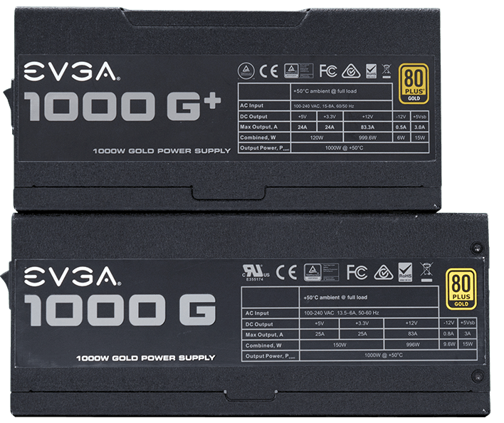

1000/850 G+
(180x150x85mm)
vs.
1000 G1
(200x150x85mm)
Shorter Length
750/650 G+
(170x150x85mm)
vs.
750/650 G1
(180x150x85mm)
When it comes to building a system, even the smallest differences can make or break your build. Each G+ power supply is between 10mm to 20mm shorter than its G1 counterpart, giving you more space without sacrificing quality.

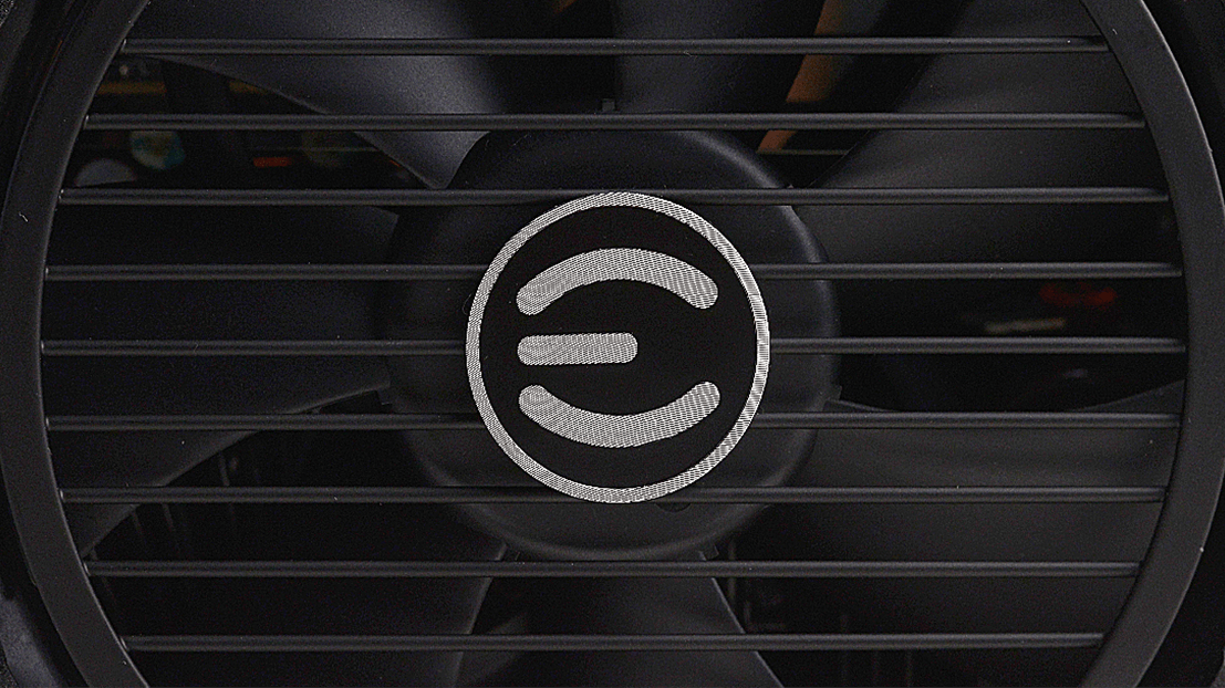

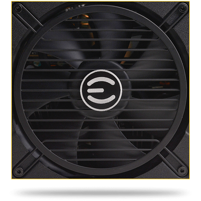

Quieter and Longer-lasting fan
G+ - 135mm Fluid
Dynamic Bearing Fan
vs.
G1 - 135mm Dual
Ball Bearing Fan
Fluid Dynamic Bearings reduce the wear and tear on a fan's bearings, reduce noise, and feature a longer-lasting life than dual ball bearing fans.

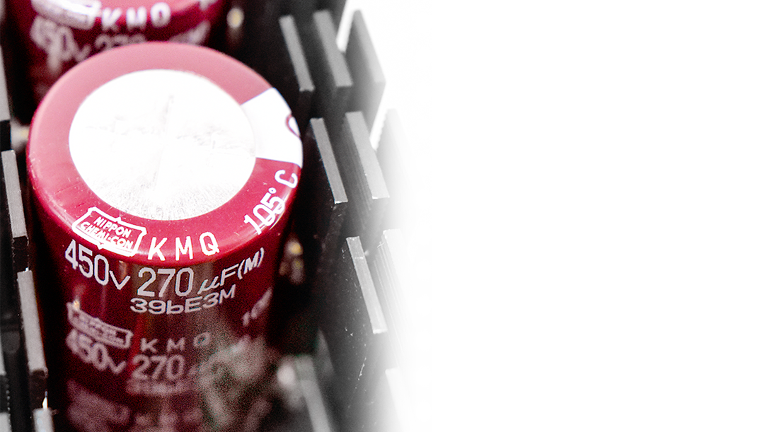

100% Japanese Capacitors
Get the most reliability and greatest performance with the use of the highest possible quality Japanese capacitors.

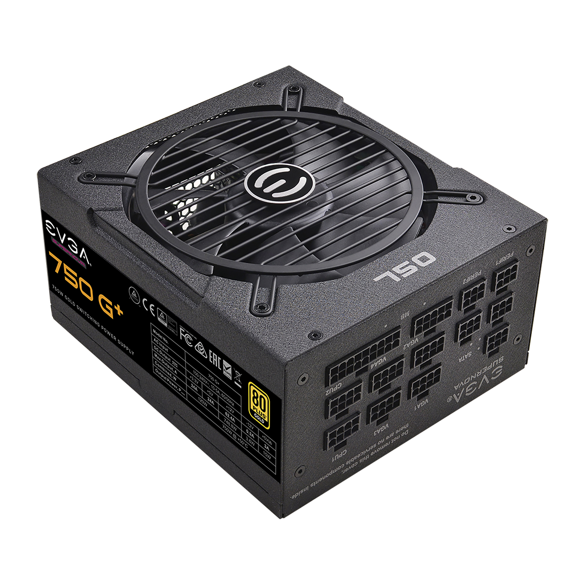

Fully Modular Design
A fully modular design allows cables to be removed from the power supply for ease of installation and removal. You can also leave off unncessary cables to reduce case clutter and maximize case airflow.

Fluid dynamic bearing fan
A high-quality 135mm fluid dynamic bearing fan gives the SuperNOVA G+ an excellent thermal and acoustic profile, and its high reliability ensures a long PSU lifetime.

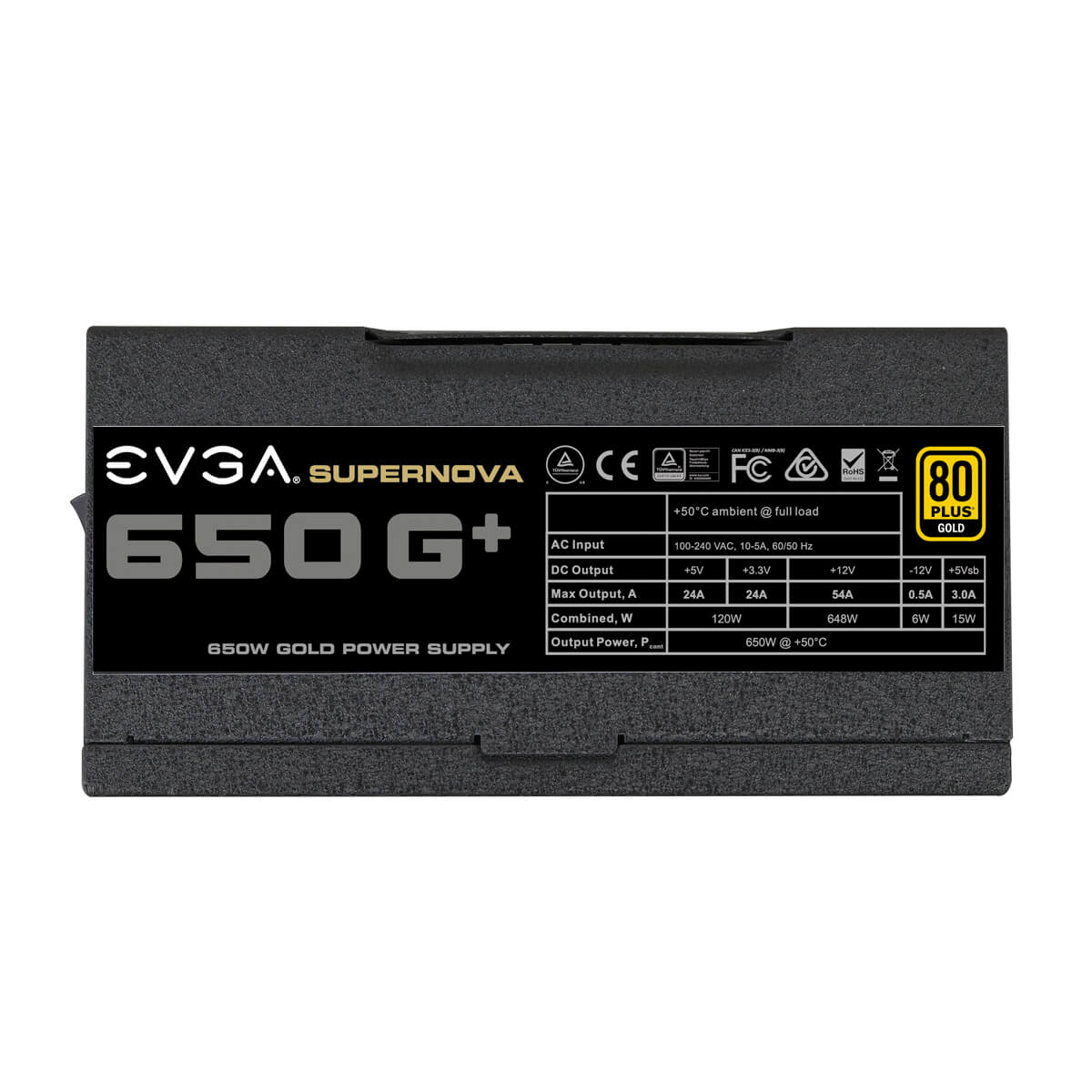

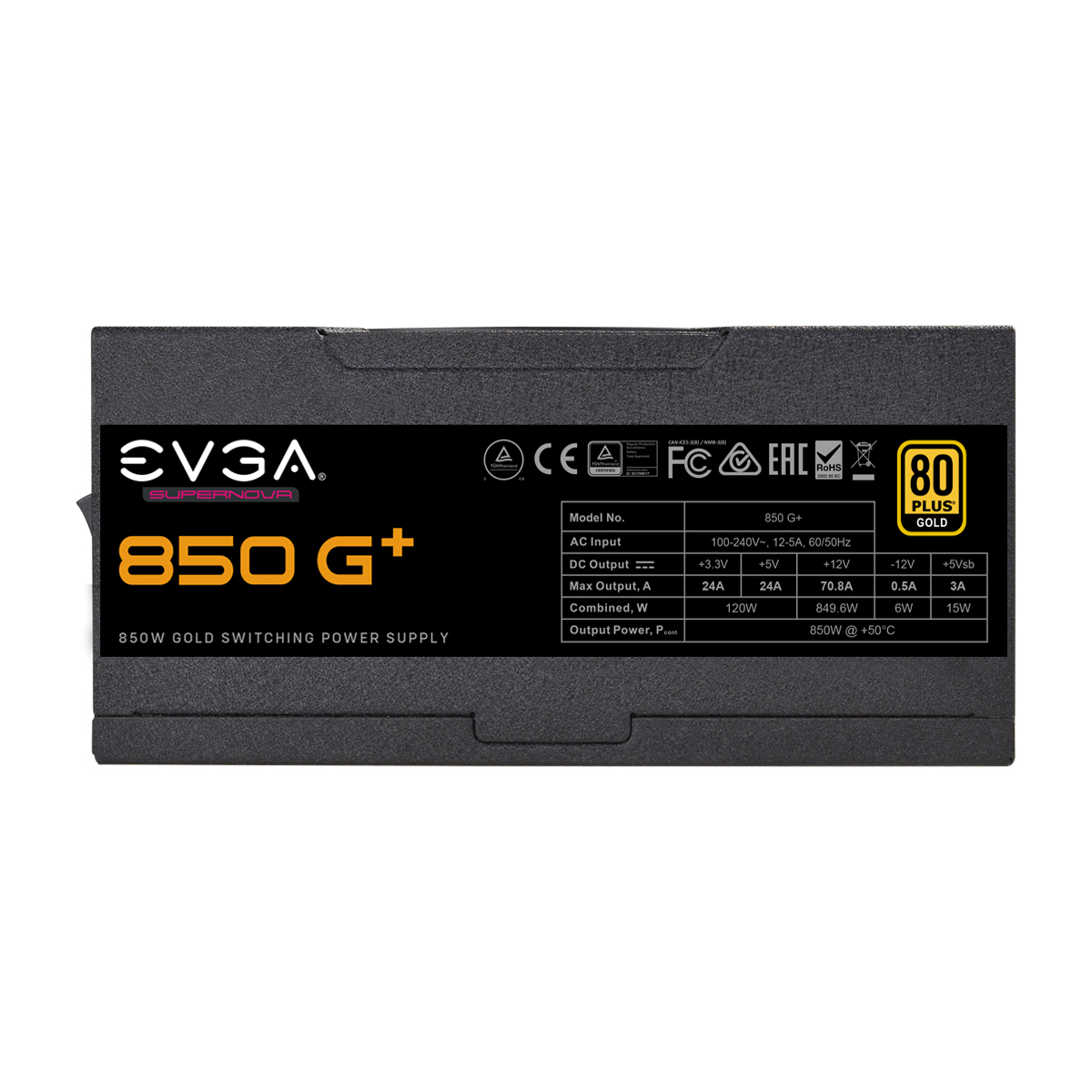

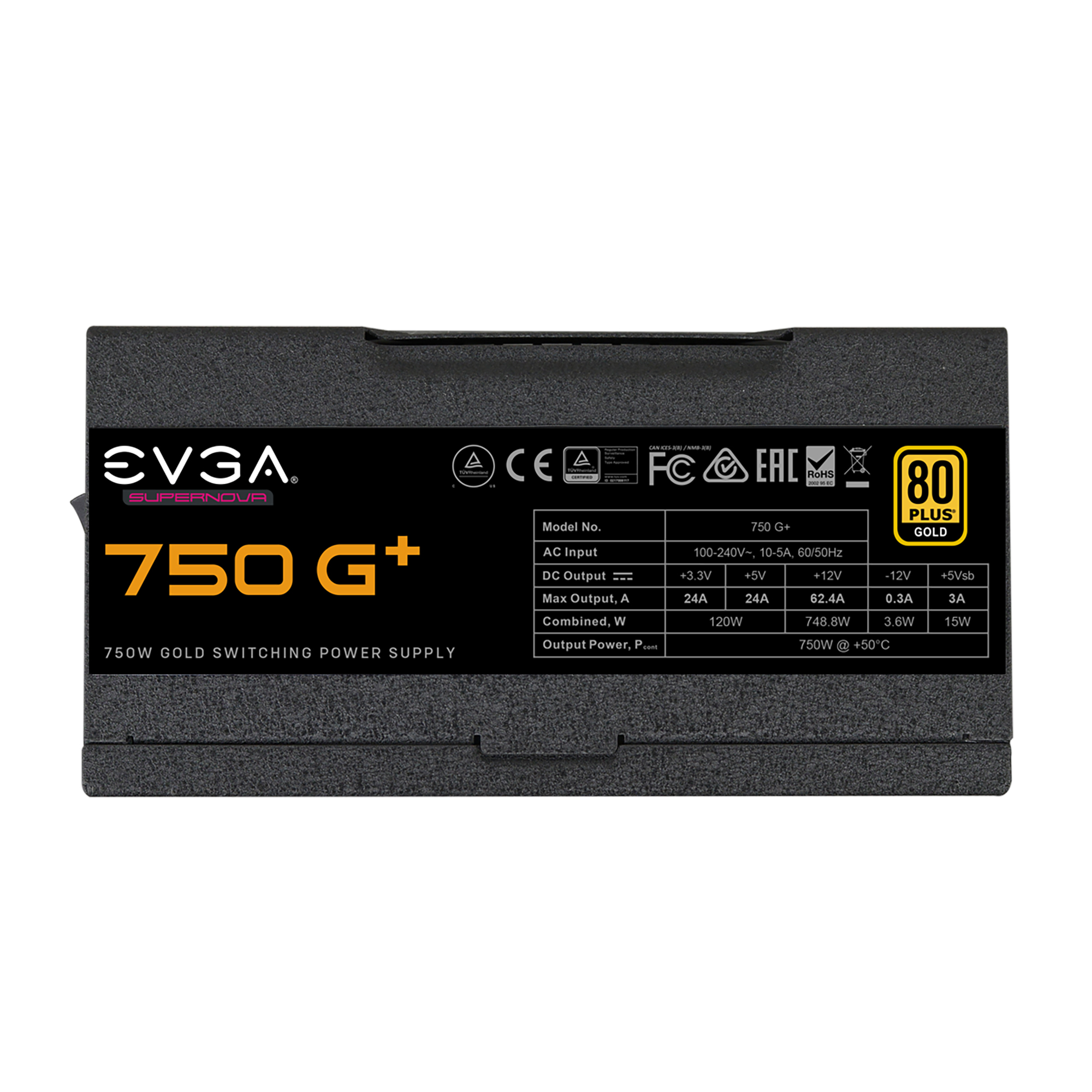

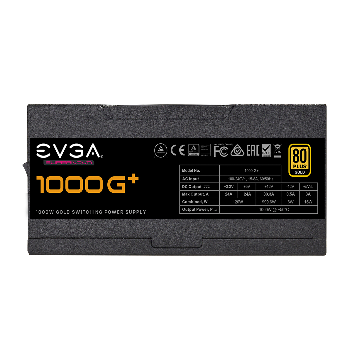

AC Input | 100-240 VAC, 15-8A, 50 - 60 Hz | ||||
DC Output | +3.3V | +5V | +12V | -12V | +5Vsb |
MAX Output | 24A | 24A | 83.3A | 0.5A | 3.0A |
999.6W | |||||
Combined | 120W | 999.6W | 6W | 15W | |
Output Power | 1000W@50°C |

AC Input | 100-240 VAC, 12-5A, 50 - 60 Hz | ||||
MAX Output | 24A | 24A | 70.8A | 0.5A | 3.0A |
849.6W | |||||
Combined | 120W | 849.6W | 6W | 15W | |
Output Power | 850W@50°C |

AC Input | 100-240 VAC, 10-5A, 50 - 60 Hz | ||||
MAX Output | 24A | 24A | 62.4A | 0.3A | 3.0A |
748.8W | |||||
Combined | 120W | 748.8W | 3.6W | 15W | |
Output Power | 750W@50°C |
MAX Output | 24A | 24A | 54A | 0.3A | 3.0A |
648W | |||||
Combined | 120W | 648W | 3.6W | 15W | |
Output Power | 650W@50°C |
